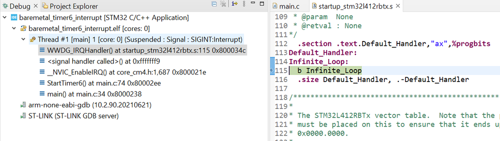

Thanks @KnarfB as you said IRQ handler was different the actual one is TIM6_DACUNDER_IRQHandler. After I changed the handler name the code started working

When I tried with Timer 2 this code is working as expected, LED blinks at 1 second interval. Is the Timer 6 of STM32L412 has any additional configuration to made in order to work like this.
This is what I get when I debug.
This happens when the specific IRQ handler is not implemented. See the interrupt vector table in the startup code for the proper names. Guess: TIM6_DAC_IRQHandler?
