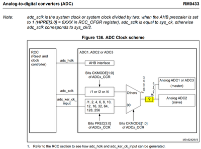

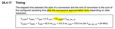

2023-08-11 5:22 AM - edited 2023-08-11 5:30 AM
You're missing:
An x2 prescaler on the ADC clock.
Extra samples due to the conversion (would be 8.5 for 16-bit conversion).

2023-08-11 6:22 AM
Thank you so much!

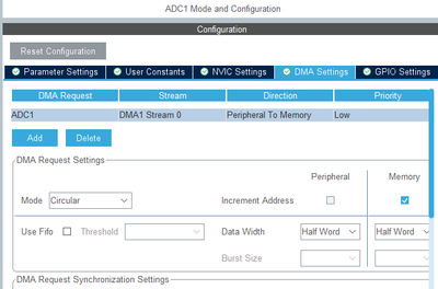

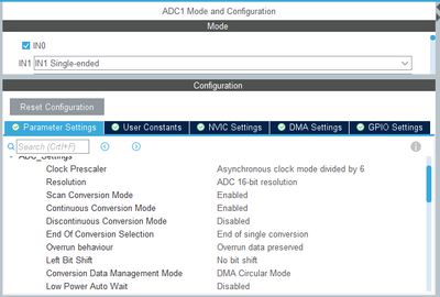

2024-01-14 10:24 PM
Query: Using STM32H743XI EVAL BOARD,
ERROR IN READING 2 ADC1 CHANNEL (PA0_C, PA1_C) IN DMA CIRCULAR MODE -
1ST CHANNEL GIVING ACCURATE COUNTS,
2ND CHANNEL SET AT 2V - ALWAYS SHOWING COUNTS SAME AS OF 1ST CHANNEL, WHERE POT IS CONNECTED?
ADC CLOCK, CONFIGS AND DMA SETTINGS AS FOLLOWS:
Tried example code also from STM32H7cubmx package (1.11.0), same result? anything missing from above configuration?
