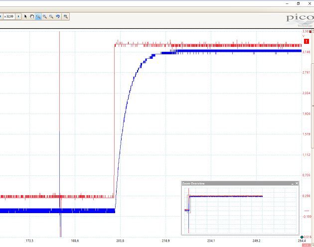

Posted on April 30, 2018 at 15:20
Thank you for your response,
I have a single 3.3V powering all the VDD and VDDA pins with 100nF capacitor for each pin.
I forget to mention that I checked both the V3.3 and NRST rise time and they were fine. here is a screenshot
I have the same circuit working with no issues on the STM32F417 !

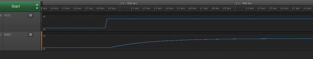

Posted on April 30, 2018 at 17:27
I have tried 10K pull up on the NRST and connecting the BOOT0 to GND (I do that on other boards) and still getting the same behavior!
Wonder If a delay between the rising of the V3.3 and NRST is necessary ? I doubled checked the curves and got the below figure :
Blue : NRST
red : 3.3V
When I force the NRST to 0 and turn on the power supply and just after I release manually  the NRST pin, the application run right away!
