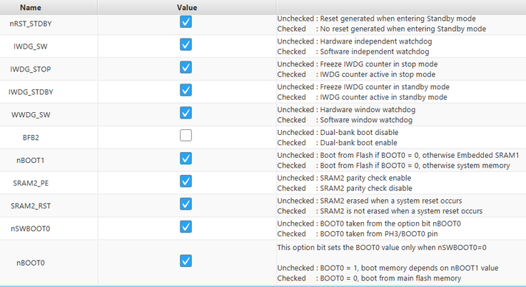

2026-04-14 11:46 PM
The option bytes are set as follows:
