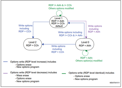

2024-09-06 9:13 AM
The RDP option byte is set to 0xCC:
Best Regards.
STTwo-32

If a device is in Protection Level 2, it is not possible to recover the MCU. You should have a new one.

2024-09-06 9:13 AM
Best Regards.
STTwo-32

Typically there needs to be code or action to cause this to occur.
Connectivity loss can result from low power modes being entered, code reconfigures the GPIO pins/banks, interfering with PA13/PA14 or others.
Connected to other circuits, damage could occur rendering the device or supplies unusable.

RDP2 is designed to prevent code extraction, and lock JTAG, by YOU or an adversary.
My approach might be for the code to determine if it's currently protected, or not, and deploy protection once programmed / or post final-test.
If you protect the device you'd need to be providing your own methodology to upgrade or configure it subsequently.
