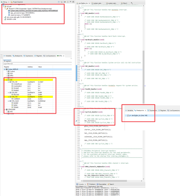

As you can see on this new screenshot :
- There's a breakpoint in the systick interrupt. after some time, the system never stop on it (and the related code is not called, so it's not a breakpoint issue).
- I paused the system, it is not in an interrupt routine
- systick registers are same as in previous post.
- If I continue debug and pause it again, the tick counter value has changed.
I feel like in the dark side...

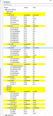

Once you are at it, show also the SCB registers' content.

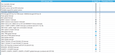

Lots of stuff happening in your Systick_handler, maybe you should use another timer for that stuff?
In case of doubt concerning the SysTick, I always build a quick 1ms-timer with interrupt which just counts upwards, same as the SysTick.
And does the Systick interrupt have the highest priority?

It finally happened!

2- Yes :

2024-08-29 8:44 PM - edited 2024-08-29 8:45 PM
VECTACTIVE of 0x1B indicates it is in the DMA1_Ch4_7_DMA2_Ch1_5_DMAMUX1_OVR interrupt. Likely this is blocking and preventing other interrupts from happening.
As @LCE mentioned, ensure systick has the highest (numerically lowest) priority if you want it to take precedence.
Also agreed it's generally bad form to call so many functions within the interrupt, especially the systick interrupt. This isn't purely for style reasons. If things accessed in these functions are also accessed in the main thread, this can lead to race conditions and other bad behavior. You aren't showing too much code here so it's anyone's guess as to what is happening. Surely it is a code bug though, not a silicon failure.

Today is a good day, I learned something: VECTACTIVE register. Thanks.
But if the microcontroler is in an interrupt state, how one can explain that if I stop the app, the call stask does not show that the code currently in execution is an interrupt? (See second screenshot posted 2024-08-08 07:29 AM)
