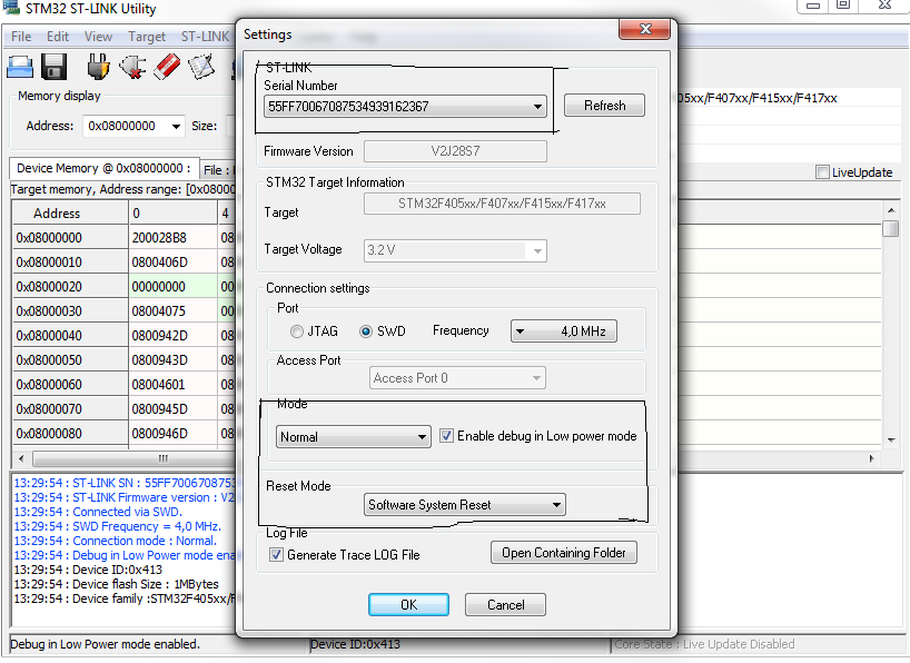

I had the same issue couple of months back. Try this setting for ST- utility and see if it works.
Also, measure your voltage across Vcap1 and Vcap2.It should be 1.26V. If Vcap1/Vcap2 is <1.26, then your ST-link is unable to detect your target.
