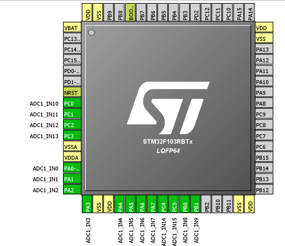

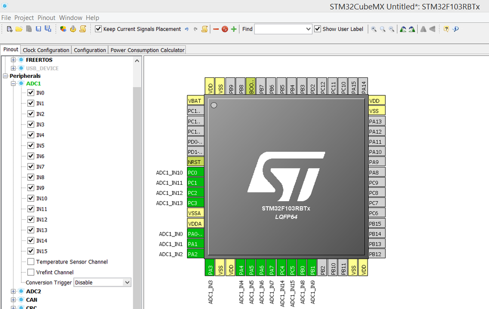

If you have problem reading datasheet try CubeMX, select the device and enable ADC 1 pins:
