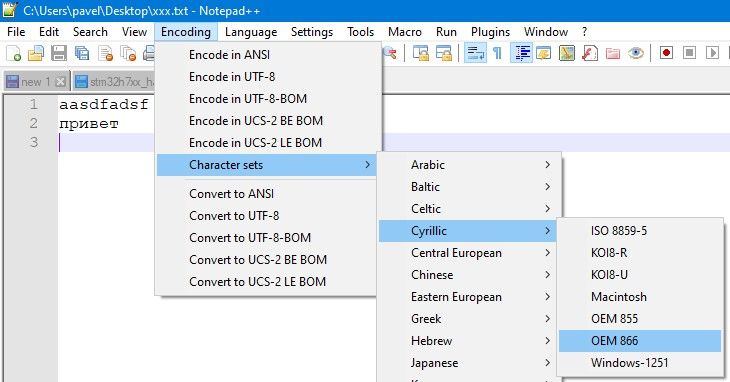

2021-01-16 5:52 AM
Do not add -fexec-charset=CP1251. Just compile as is. Source with CP866 strings compiles for me with gcc v7 in Linux.
2021-01-16 7:17 AM
I'm a novice programmer. Explain in more detail. How did you enable cp866?
