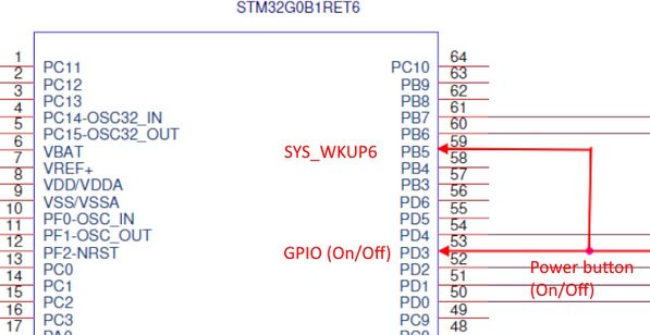

I am looking for a software solution for this race condition:
* The power button is connected to both the On/Off pin PD3 and the wakeup pin PB5. See the partial schematic.
* The issue is that the STM32G0 enters shutdown mode, but immediately wakes up. Please see my function below.
What is missing? Thank you!

2026-03-30 10:14 AM
What is missing is disabling systick. Could be other things.
2026-03-31 2:28 AM
Hello @Kmax18
In addition to @TDK recommandation, you should:
/* Enable PWR clock */
__HAL_RCC_PWR_CLK_ENABLE();
/* Clear all wakeup flags and shutdown/standby flags */
__HAL_PWR_CLEAR_FLAG(PWR_FLAG_WUF1 | PWR_FLAG_WUF2 | PWR_FLAG_WUF3 |
PWR_FLAG_WUF4 | PWR_FLAG_WUF5 | PWR_FLAG_WUF6 |
PWR_FLAG_SB);
