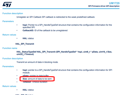

Documentation should be clearer:
Always give units !
Note also that units are needed for the Timeout parameter.
2024-02-18 1:24 AM - edited 2024-02-18 1:25 AM
@Andrew Neil , thank you for your feedback and for helping us improve the ST documentations!
Your request has been escalated via internal ticket number 173729.
(PS: internal ticket number 173729 is only for reference, not available outside of ST).
2024-02-18 1:39 AM
Yes, but what are units in this particular case?
Pieces. It even has an abbreviation (pcs). Not an SI unit, though.
Would you be satisfied with this "unit"?
2024-02-18 6:02 AM
@waclawek.jan wrote:Yes, but what are units in this particular case?
They are multiples of the "data size" set by SPI_InitTypeDef::DataSize
That also needs to be better documented:
Is that bits or bytes?
(the values of SPI_Data_Size do suggest that it's bits)
