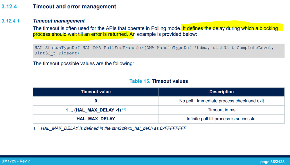

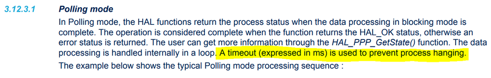

Hello @Chrizzly ,
I advise your to check the user manual "Description of STM32XXxx HAL driver" (as this User manual), to have an overview of the HAL drivers with the configuration of the functions, and how to use the given API.
Imen
