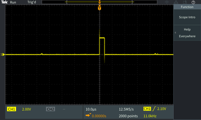

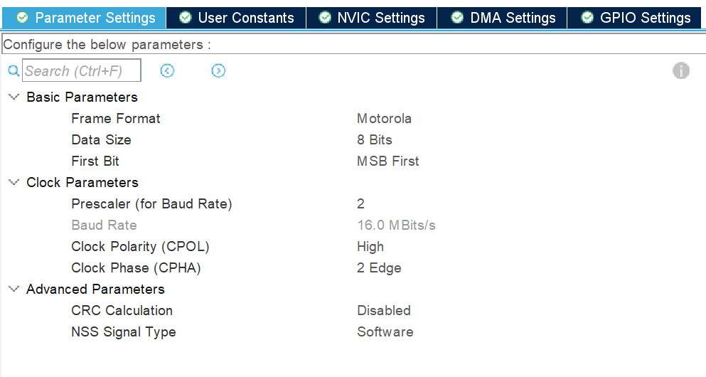

I tried out your suggestion and it worked (on both cpol low & cpha 1 and cpol high & cpha 2). Now I can see data on the MISO line on the oscilloscope and the debugger. However I read on the MISO line 0x40 in spite of the WhoAmI register should contain 0x47. Do you have and idea where that 0x07 goes?
2024-04-17 3:58 AM
@AndrasToth wrote:I read on the MISO line 0x40 in
Is that the value you see on your scope, or the value you receive in your software?
2024-04-17 4:05 AM
I read the 0x40 in the software and I can see the following on the oscilloscope:

Try (with settings , as i wrote) to read some other registers , that have a known (default) value .
Just to verify , the chip is now "understanding" the spi input and response is also as it should be.

I configured it as you suggested (cpol high & cpha 2) using STM32CubeIde 1.13.2, but I can't find in the advanced parameters the Master keep IO state option.
Which .c file do I have to write a code that can manually enable this setting?

I am not sure about - WB55 cpu i dont have (and i cannot look here - i am at work),
but most SPI have this setting : in Advanced parameters (in Cube) you should see it (or this SPI dont have it , then also ok.)
Its just : to keep the spi lines at its active state, between transmissions etc. , to avoid target "see" a extra pulse.
If you dont see this setting , its ok. (Then this spi should do it anyway.)

@AndrasToth wrote:I can see the following on the oscilloscope:
What's that looking at?! :flushed_face:
You need to look at the full SPI transaction - is the slave actually sending 0x40, or 0x47, or ... ?
Also, does what your STM32 actually sends on the wires match the slave specs?
Does your scope have the capability to decode SPI?
Surely, a Tektronix scope has a way to capture a proper screenshot?
It was the reply on MISO line to the read command, but I'll capture a better one.
I did and that was the only signal.

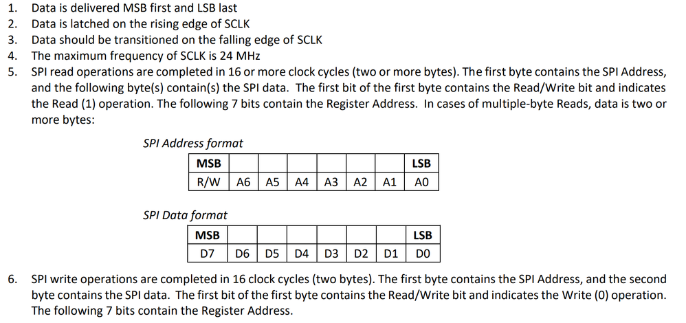

Yes it should be. The first bit of the first byte declare that the command will be a read(1) or write(0) command and next 7 bit is the address, which for the WhoAmI is 0x75.

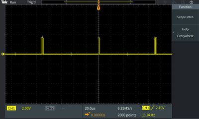

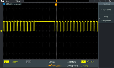

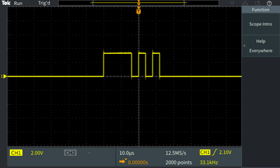

The following pictures from the oscilloscope:
CLK:
CS:
MOSI ( 0x75 | 0x80 is 0b11110101 and I think this signal is exactly the same):
MISO:
