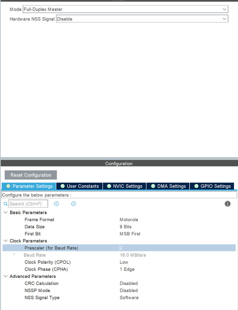

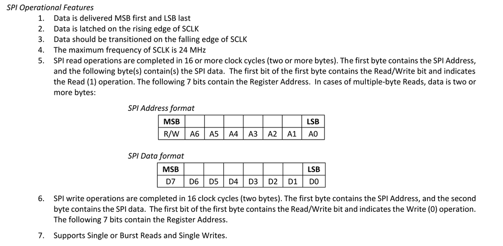

I'm trying to communicate with a slave device (ICM-42688-P: https://invensense.tdk.com/wp-content/uploads/2020/04/ds-000347_icm-42688-p-datasheet.pdf), but I don't recieve anything on the MISO line. I'm using the nucleo-wb55rg for the master device. The ICM-42688 typically needs 1.8V for the VDD and VDDIO, but the datasheet says it can be used between the range of 1.71V and 3.6V. Therefore I just used the nucleo's 3.3V pin output to power both. After that I configured the SPI following the datasheet:
The code I wrote for excercise is a read from the whoAmI register, which is at address 0x75 and contains the value of 0x47. However I only get 0s from the MISO line.

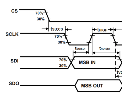

The datasheet doesn't suggest any need for delays:

2024-04-15 8:58 AM - edited 2024-04-15 9:08 AM
look closer the SDO line is shifted a little bit to the right
so maybe you need only HAL_Delay(1) to do the job
he also deselects the chip too fast
HAL_GPIO_WritePin(GPIOA, GPIO_PIN_4, GPIO_PIN_SET);
before it can process the response.
if you are pounding it so fast in while() loop it might not work.
the response is never instantaneous it needs time to process data and request.
2024-04-15 9:34 AM
that's within the timing of the hardware peripheral - not a software delay between read & write.

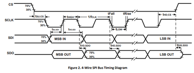

2024-04-15 9:50 AM - edited 2024-04-15 9:57 AM
(after 30 mins on ds ...)
1. spi clk mode is wrong:
set : cpol hi + cpha 2edge (as i see from this timing diagram)
+ set in Cube/ioc :
