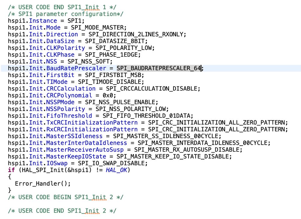

This is my set up:
The intend to test the various operation modes: polling, IT, DMA.. Already tried all of them but got the same issue. By now I'll be happy to see it functioning just in the polling mode, for this I'm using HAL_SPI_Receive(&hspi1, buffer, 32, 100).

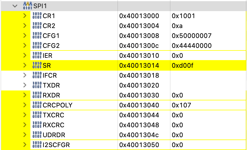

This is the SPI1 register before the: SET_BIT(hspi->Instance->CR1, SPI_CR1_CSTART);

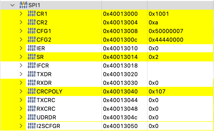

This is right after:
