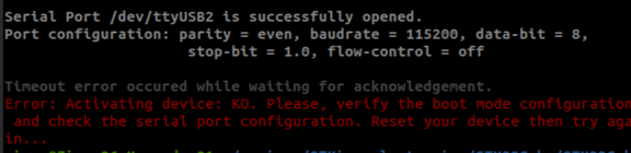

I am using STM32G0B1cbt6. And I am using native bootloader to update firmware. But in some boards not able to update firmware, it is giving below error:
And when we replaced the MCU then bootloader started working normally.
The failure percentage is like out of 100, in 5 to 10 MCUs we are facing problem.

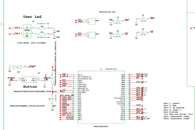

Is this on a custom board?
If so, please post the schematic.

Yes, this is a custom board.
I am attaching the schematic below. Which running on standard 3.3V supply.

ASsyou use HSI, maybe HSI may be slightly out of range.Check serial communication with a scope to check for frequency mismatch. Try heating or cooling the non responding devices to move HSI frquency
B,t,w, NRST Pullup is deprecated
