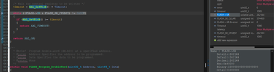

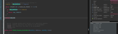

I checked when its was set to 1(these flags was cleared in prevous wait)- and it was set in this while loop in previous wait, whitch is chegking only 18th bit:
while ((FLASH->SR & FLASH_SR_CFGBSY) != 0x00U)
if (HAL_GetTick() >= timeout)
return HAL_TIMEOUT;
before loop:
after loop:
