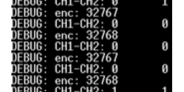

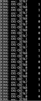

2025-05-26 2:57 AM
Above are the signals of CH1 and CH2 of TIM2, seem like they are not running in a wrong pattern. However when I used TIM1, the signals on CH1 and CH2 are in the correct pattern.

2025-05-26 5:08 PM - edited 2025-05-26 5:09 PM
Not real clear what output we're looking at here, but it's clear the encoder value is changing despite the channels staying the same, so I suspect encoder and channel output is not in sync, or is otherwise incorrect/unreliable.
Encoder value swapping precisely between 32768 and 32767 after every call suggests problems.
Perhaps SB13 isn't really gone, or other code issues are present.
