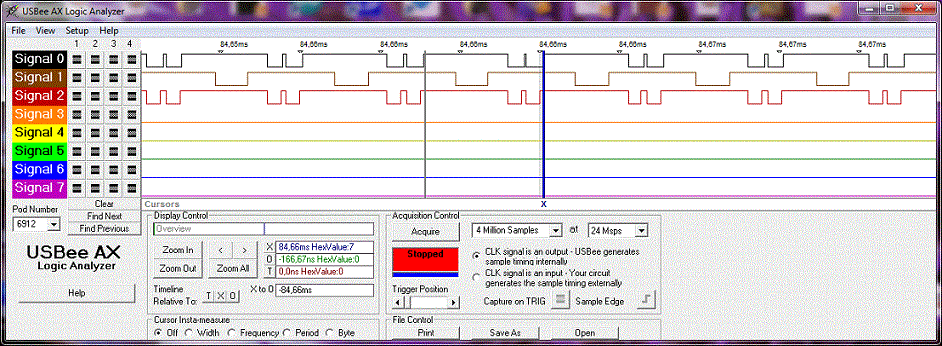

I want to use FSMC module, but I'm not sure that it settings correct. There is write operation on a picture. I see multiple NWE activation. And sometime it release NEx together NWE (should be NWE and than NEx). What should I do for diagram like Figure 437 from ? Or, possible, I don't understand something?typedef

At 24 Msamples per second you are probably not capturing single write pulses - if you run the mcu at 168MHz, they should last around 40ns. Show us also the capture of your ''marker'' signal, not hand-drawn lines.
Also, I don't speak the library gobbledygook, but it appears to me that you set FSMC for multiplexed memory but you don't initialize FSMC_NL, I suspect you do this in error. JW2014-11-25 6:55 PM

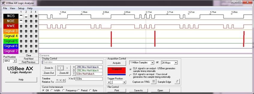

Thank you! You was right - samplerate was too low. It worked on default frequency - 16MHz HSI (not 168MHz, of course! ), but samples couldn't show all details. For 16MHz need 32MHz sample frequency minimum (as told Nyqist and Kotelnikov).
I addedRCC_HCLKConfig( RCC_SYSCLK_Div4);
// make it slow
and now I have this one. Black - NEx,red
- NWE,brown
- soft strobe (see source upper):2014-11-26 10:29 AM

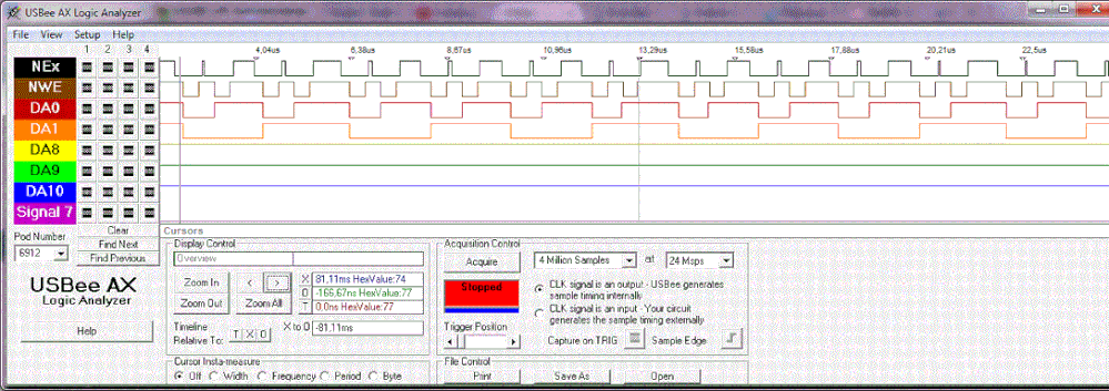

So, I need ModeA or ModeD. It means, I should use extended mode and write timings in both BTR1 and BWTR1 ( bank 1 for NOR/PSRAM). I declare structure for IO:#define

As I know, pin PE11 (DA8) must be output for the lowest address bit when I select MUXEN=0x0 and MWID=0x0 (equ 8bit). Right?
But logic analyser show me - wire doesn't changed! In multiplexed mode it changed address but started value is 'full in 1', then 00, 01,... I haven't idea anymore!
