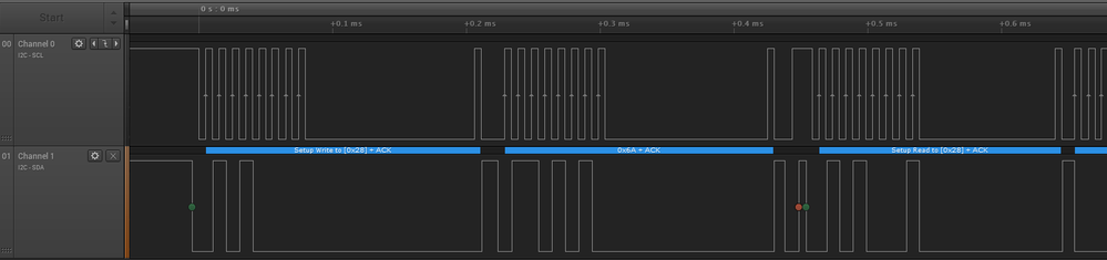

I am attempting to get an STM32F411CE microcontroller to interface with a BNO055 IMU using the I2C peripheral. This particular IMU uses clock stretching which doesn't seem to work with the HAL_I2C library that was auto-generated from STM32CubeMX. See image below:
I attached a second I2C device to the bus and was able to communicate with the library so I'm pretty sure it is only the clock stretching that is causing an issue.
As a reference, here is a waveform of an Atmel microcontroller interfacing with the same BNO055 device and it appears to be working as intended:
Any ideas on what could be causing this issue?

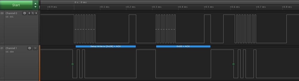

Just an update. It appears the SCL line is not dropping low to finalize the transfer. As a fix, I added a function at the end of each data write to manually pull the SCL line low which seems to get the peripheral working again. Here is the fix:
static void i2c_tx_scl_fix(void)
{ uint16_t SCL_PIN = GPIO_PIN_8;// Re-configure SCL as input
GPIO_InitTypeDef gpio; gpio.Pin = SCL_PIN; gpio.Mode = GPIO_MODE_INPUT; gpio.Pull = GPIO_PULLUP; gpio.Speed = GPIO_SPEED_FREQ_LOW; HAL_GPIO_Init(GPIOB, &gpio);// Wait until SCL line goes high
while(HAL_GPIO_ReadPin(GPIOB, SCL_PIN)==GPIO_PIN_RESET){}// Now configure SCL to output and force low to
// regain control of SDA gpio.Pin = SCL_PIN; gpio.Mode = GPIO_MODE_OUTPUT_OD; gpio.Pull = GPIO_NOPULL; gpio.Speed = GPIO_SPEED_FREQ_LOW; HAL_GPIO_WritePin(GPIOB, SCL_PIN, GPIO_PIN_RESET); HAL_GPIO_Init(GPIOB, &gpio);// Reset back to I2C configuration
gpio.Pin = SCL_PIN; gpio.Mode = GPIO_MODE_AF_OD; gpio.Alternate = GPIO_AF4_I2C1; gpio.Pull = GPIO_PULLUP; HAL_GPIO_WritePin(GPIOB, SCL_PIN, GPIO_PIN_RESET); HAL_GPIO_Init(GPIOB, &gpio);}and here is the updated HAL_I2C_Master_Transmit function:

} else {return HAL_BUSY; }}I am still having trouble with the HAL_I2C_Master_Receive function. See waveform below:
Again, the peripheral seems to get stuck in a state that is preventing it from sending the next byte.

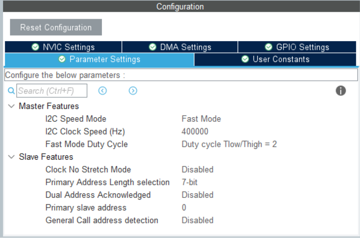

Yes I tried.
My i2c configuration is:
And this is my read function:

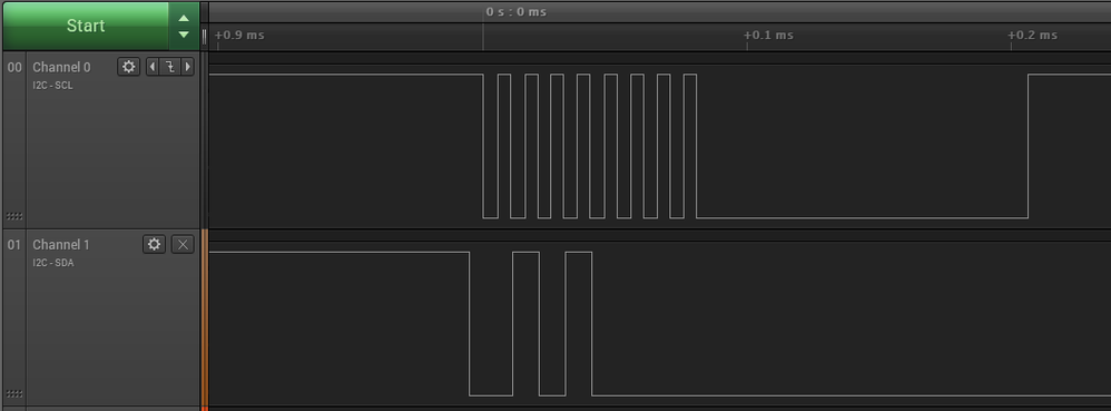

}I saw the line with a logic analyzer and then I thought may BNO055 keeps the lines low.
