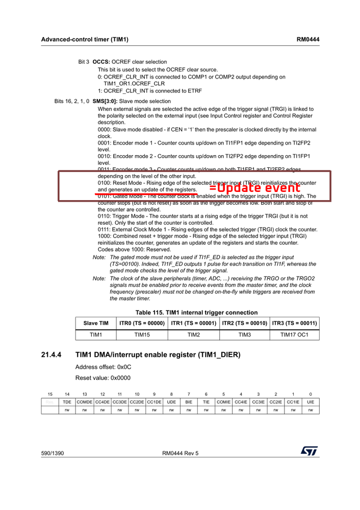

return ((READ_BIT(TIMx->SR, TIM_SR_UIF) == (TIM_SR_UIF)) ? 1UL : 0UL);My point is - there should NOT be an update event when Capture happens, since timer is configured in slave reset mode. The rising edge of the pulse should reset counter to 0 way before it reaches ARR. At least this is my understanding of how it supposed to work, but I can be mistaken, of course.

I did not interpret "updates registers" as an update event generation. It would explain why UIF flag is set. But it does not explain why CC1IF/CC2IF flags are NOT set.
