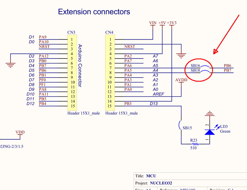

2023-04-12 3:49 AM
Double check signal paths, connections and solder bridges options for related pins on the schematic.
Check also Errata docs.
2023-04-12 3:49 AM
2023-04-12 6:31 AM - edited 2023-11-20 8:25 AM
> and solder bridges
Indeed - SB16 and SB18.
2023-04-12 7:10 AM
Thank you Tesla, you are probably right - I looked into UM1956 to check the schematics and I noticed something that I should have noticed a long time ago, but I was so sure that the default setup must work since I haven't made any changes to the soldering bridges.
But alas, UM1956 says for SB16 (pp20-21):
STM32 PB6 is connected to CN4 pin 7 for I2C SDA support on
Arduino Nano A5. In such case STM32 PB6 does not support
Arduino Nano D5 and PA6 must be configured as input floating.
The schematics further reveals that PB6 is linked to PA6 and PB7 to PA5. Which obviously explains why my I2C peripheral would get wrecked if I setup constant high signal on those pins.
Now, I have some desoldering to do to verify this resolves the issue but looks like a very dumb overlook my side (but why would anyone solder 2 pins together...) :) Thanks again!
2023-04-12 7:23 AM
Yes, that's exactly what I completely ignored although I've skimmed through that manual 50 times in the last week... Also explains the issue I had in the past with Nucleo-L412KB. I just somehow never registered, that they have pins soldered to connect...
