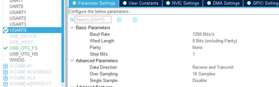

I am having uart baudrate problems while HSI clock as uart source clock. No problem with PCLK as source with the same uart.

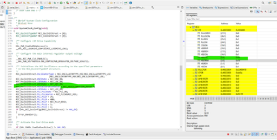

In Cube IDE (V1.16.0) and F7 software package (V.17.2), I get different values for HSI_CALIBRATION:
Ide gets as 0x10 while register (RCC_CR) has 0x68 as HSI_CALIBRATION. The register also has 0x10 for HSI Trim value, which made me confused:
Any pointers which value to use for calibration?

2024-08-06 12:06 AM
Need low bps (1200) for uart and high clock rate (100MHz) for others. cant go down to 1200 bps with 100MHz

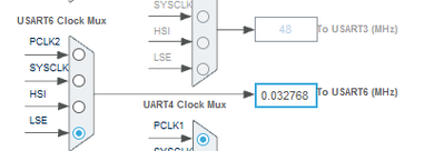

2024-08-06 1:00 AM
But you could choose other source, here at 48M (anyway for USB needed) or LSE for 1200 baud:

2024-08-06 2:03 AM
+ and LSE :
at 1.1% max. error , much better than HSI ( 4% error ...)
Just try it !

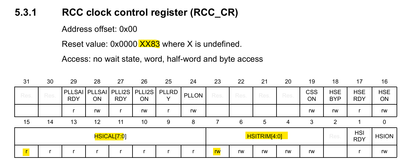

2024-08-06 4:59 AM - edited 2024-08-06 5:00 AM
HSITRIM = 0x10 is the default value, and is as expected. No issues there.
HSICAL gets initialized at startup using calibration values loaded during production.
If you want to trim the HSI, HSITRIM is the register to change. HSICAL is read-only.

2024-08-06 5:31 AM
So HSI_CAL has 32 config ( five bytes - HSITRIM) table then. Thanks
