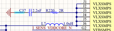

Same question on the VLXSMPS pins... do we need the capacitors on these pins, or can they be left as no connect?
Also, on the STM32N657-DK board, there is a snubber circuit on the VLXSMPS pins, why?

(So does VLXSMPS.)

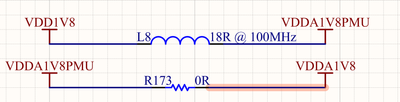

2- No on the STM32N6570-DK board, the VCCA18PMU pin seems to be floating:
VDDA1V8PMU is connected to VDD1V8 thru and inductor L8
and also connected to VDDA1V8 thru R173 which is not installed

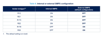

VDD1V8 is generated by external switcher, but R21 is a no install
and since the VDDA18PMU is floating, the VDD1V8 is all floating from the STM32
SMPS stuff table for the STM32N6570-DK board....
Very confusing design here....

AN5967, RM6486, UM3300, and the STM32N657x0-dk development board schematics seem to contradict each other.... which one is correct regarding the SMPS configuration?
2025-10-28 1:52 AM
Hi @matt-crc
The STM32N657-DK board was designated very early compared to AN5967 Rev3, so there are some differences regarding the internal SMPS and bypass (figure 4 of AN5967).
However, you must consider the recommendations of AN5967 as indicated in DS14791 Rev7 in section 3.4.4 SMPS usage.That is, connect VDDA18PMU and VDDSMS + VFBSMPS to GND when the design is SMPS Bypass.
The RM0486, UM3300 are not intended to explain how to implement the internal SMPS or Bypass; that is the role of the AN5967.
Apart from this point, let me know if you see other contradictions between the different documents?
