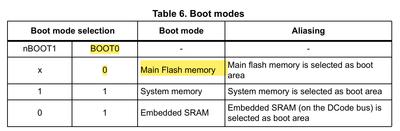

These options don't override the BOOT0 signal and the BOOT_SEL option byte doesn't exist on this chip.
The BOOT0 pin is always sampled on startup and must be low to boot into flash memory. You will have to wire it to ground directly or through a pullup. nBOOT1 value doesn't matter.
