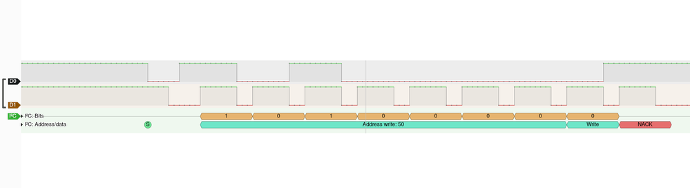

2025-10-12 3:15 PM
Hooking my code to a logic analyzer I can see that the master device sends the correct address, 0x50. But followup data is ignored. (I changed the I2C address in the code from 0x08 to 0x50.)

2025-10-13 2:42 AM - edited 2025-10-13 2:45 AM
@Archadious wrote:Hooking my code to a logic analyzer I can see that the master device sends the correct address, 0x50.
As @Ozone said, are you sure that 0x50 is the correct 7-bit address?
More on common & widespread confusion & misrepresentation of I2C addresses:
@Archadious wrote:But followup data is ignored.
Which very much suggests that the address is not what the slave is expecting.
Have you tried just doing a scan of all possible I2C addresses?
Again, Have you looked at ST's examples for the stm32g0 ?
Have you used an oscilloscope to verify that the signal is good in the analogue domain? If it's not, the LA won't be giving useful information.
