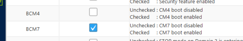

You can disable CM4 with option bytes with CubeProgrammer, so you will be in Single core config:
2024-10-18 2:46 PM
2024-10-23 9:19 AM
Thanks. As I'm new to the STM32 line, I was unsure where to find it.
