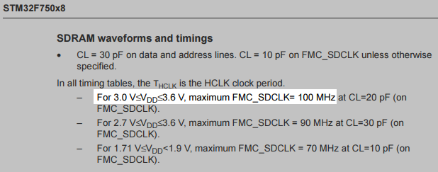

2020-06-02 11:29 PM
Look for SDRAM waveforms and timings in the datasheet.
2020-06-03 1:33 AM
Well, that is the point, I did all that and below the computation I did:
Still, I have a RAM test which is passing but I get random faults with incomprehensible CPU registers content when accessing the SDRAM, so clearly I am missing something.
My point is that if the board supports this as a max frequency, why doesn't STM provide a working configuration?
2020-06-03 1:58 AM
2020-06-03 3:32 AM
Many thanks, I missed that. We can consider this topic closed
