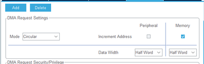

After decreasing the size of the table to 128, and modify the DMA configuration for TX and RX like this :

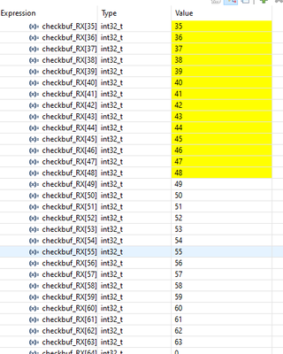

2x128x1/(110.10e -6) = 2.3µs x 4 (factor) = 9.3 µs which is less than 27µs. But I have only half of the data, looks like the other half is not working. I certainly forgot a few things but what ?

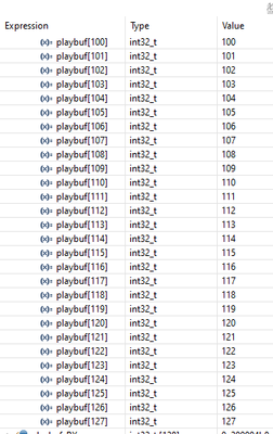

And yet my TX table is correct

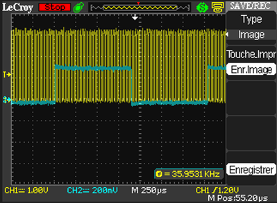

For the scope I have (yellow : data. blue : FS)

Show the function processData_2(), it should look something like this:
void processData_2()
{ for( int32_t n = (BUFFER_SIZE / 2); n < BUFFER_SIZE; n++ )
checkbuf_RX[n]=playbuf_RX[n];
dataReadyFlag_2 = 0;
2024-01-22 7:34 AM - edited 2024-01-22 7:40 AM
I think it's the same
void processData_2 ()
for (int32_t n=64; n<BUFFER_SIZE; n++)
dataReadyFlag_2=0;

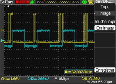

To check that both flags are set: in processData_1() (better call it "half" or so than "1") set a GPIO high, in processData_2() (better call it "full" or so than "2") set the same GPIO low again. If both flags are set and reset again, the GPIO should toggle with a rate equal to sampling rate / buffer size. Check with scope.
2024-01-24 1:58 AM - edited 2024-01-24 4:17 AM
I'll come back with the curves.The result is not there but I have values.
yellow :FS / blue : led flashing
My sample rate is 44.1 kHz (real : 35.7 kHz). So sampling rate/128 = 278 Hz (about), but I have 571 Hz (about twice as much). I'm Debug mode and maybe in Release mode that would change something ?
