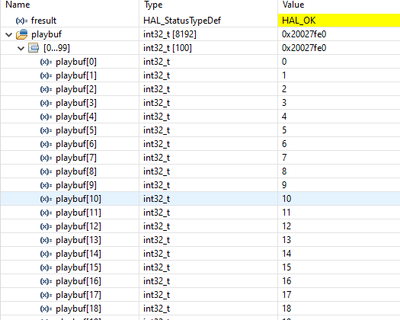

I have this code
// Initialiser le bloc A
fresult= HAL_SAI_Init(&hsai_BlockA1);
if (fresult != HAL_OK)
return HAL_ERROR;
// Initialiser le bloc B
fresult= HAL_SAI_Init(&hsai_BlockB1);
return HAL_ERROR;
// Transmission
fresult = HAL_SAI_Transmit(&hsai_BlockB1, (uint8_t *)playbuf, (sizeof(playbuf))/4, 0xFF);
return HAL_ERROR;
// Reception
fresult = HAL_SAI_Receive(&hsai_BlockA1, (uint8_t *)playbuf_RX, (sizeof(playbuf_RX))/4, 0xFF);
return HAL_ERROR;
I am not receiving some of the data, do you know where I can find the documentation to implement SAI blocking mode? thanks in advance.

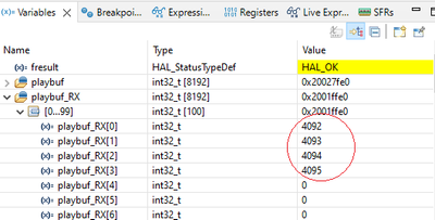

In my reception array I have only a part of data, and yet my TX table is well initialized like this :
2024-01-08 10:08 PM
You need to understand what's going on there:
- HAL_SAI_Transmit() seems to return when data transfer to the SAI's FIFO has finished
- HAL_SAI_Receive() is started when there is only the data in the TX FIFO
Again, DMA is for most applications the best solution.
Anyway, isn't there some combined start function for TX & RX? Check the SAI HAL file...

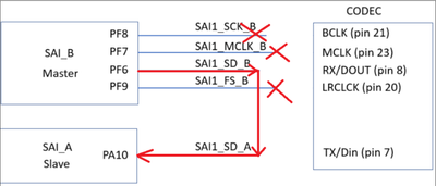

Just one think, I used this configuration in my previous post :
Can I use this same method : Connecting TX with the RX (so for the moment the CODEC is of no use to me). Can I code (circulaire mechanism, IRQ...) with this configuration before actually plugging in the CODEC ?
2024-01-10 1:52 AM
Sure, why not?
IMPORTANT: do not only rely on software tools, monitor the SD TX pin with a scope. And as I said before, trigger scope on FS = LRCK.
And focus on getting the TX part running continuously via DMA. Only then start the RX part.
