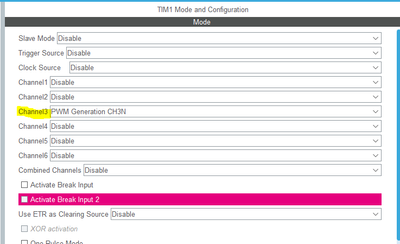

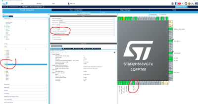

2024-01-22 6:07 AM
Hello @JonConesa
Try using TIM1_CH3N on PB1

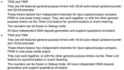

2024-01-24 12:23 AM
I'm sorry for taking so long to respond.
I have a custom board with the STM32F563VGTx MCU. That's why I chose Timer 3 CHANNEL4, as it turned out to be the most suitable option for routing. Furthermore, when testing Timer 5, it worked correctly in generating PWM through DMA. Is it possible that I can only generate DMA with Timers 2 and 5?
