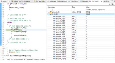

}But something is wrong, in my playbuf_RX array is never reset to 0 yet I enter it in the void Reset_playbuf_RX function.
Probably it runs continuously via the DMA and I don't have control of the playbuf_RX?

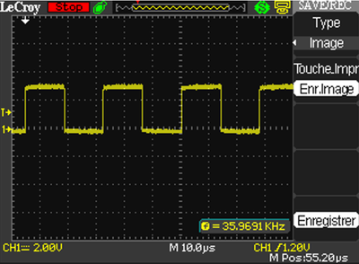

{return HAL_ERROR;}When I look at my LRCLK :
And on the TX signal, I have signals that run continuously
How to recover the transmitted signals ? I certainly forgot some functions but what ? Thank you for your advice

a) dataReadyFlag is set at HALF complete. Why?
b) dataReadyFlag is reset where?
c) I wonder why you ever see playbuf_RX[] not = 0, because your while loop makes no sense.
What your while loop does:
- START: reset playbuf_RX[] = 0
- wait 1 ms
- if dataReadyFlag is set in HALF complete, then you copy playbuf (the DAC buffer?) into playbuf_RX, basically overwriting what the DMA put in there
- and then, 1 ms later you go to START and reset playbuf_RX again
This makes NO sense at all and you're really molesting the DMA buffer by constantly resetting and copying - or I just don't get it.

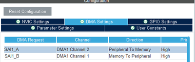

I don't understand where the DMA data is stored ? In my configuration SAI1_A (the slave : CODEC)
Peripheral : SAI_RX
Memory : ? Where and how to read this datas when the Flag RX =1 (HAL_SAI_RxCpltCallback, I make a mistake here).

I have 2 signals (blue : data (probe x10). yellow : LRCLK)
You should at least read the HAL source function descriptions.
Then you would find for HAL_SAI_Receive_DMA
HAL_SAI_Receive_DMA(&hsai_BlockA1, (uint8_t *)playbuf_RX, (sizeof(playbuf_RX))/4);
playbuf_RX (= memory) is the data buffer you hand over to the DMA, and that's where DMA writes the data it gets from the SAI RX peripheral.

Scope:
Your scope does NOT show LRCK ( = FS in STM lingo), but probably SCLK ( = CK or so, the bit clock).
LRCK frequency equals the sampling rate, and within one half period you should see one data sample.
If you have 3 channels, then simply add LRCK, and trigger on that.

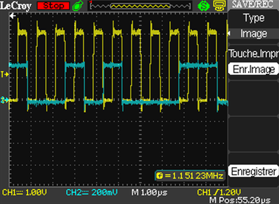

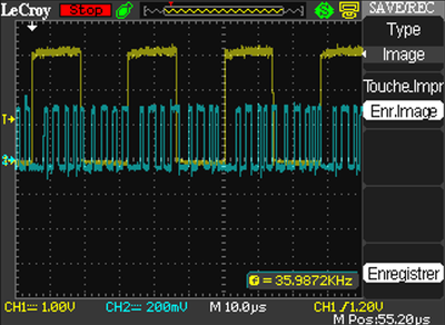

For the scope you're right about FS (yellow) Data (blue) now I have this :
Now I understand better what DMA and memory are. A confusion on my part however, I think that we need a way to check that what we have received corresponds to the transmission. Maybe a pointer to this playbuf_RX array so as not to slow down DMA reception ?
2024-01-17 8:10 AM
Scope: now that looks better!
I guess that there's some up-counting going on, because only the LSBs are changing.

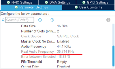

LRCK ~= 36 kHz - is that what you expected from your SAI TX settings?
At 36 kHz, one sampling period is about 27 µs. Check how many buffers you could read or reset within that time, depends on your CPU clock. As a rule of thumb, take factor 4 for each for loop iteration.

Thank you very much for this very useful information (at least for me). I think after my configuration the LRCL is correct (Real Audio Frequency ?) :
