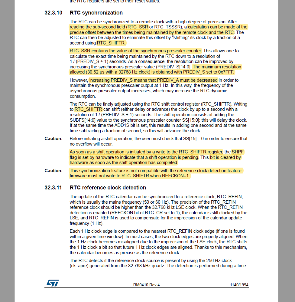

2020-04-24 2:51 AM
If you look at the last section of the STM32F7 Reference Manual RTC synchronization that tells you about how to advance or delay adding into SSR using SUB bits of SHIFTR.
Let me know if you need any more help.
