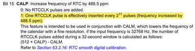

I want to adjust a known RTC drift (e.g., 500ms) over time using the RTC’s smooth calibration feature. I understand that I can configure the calibration window to 32s, 16s, or 8s using the SmoothCalibPeriod parameter, and that I can add or subtract pulses (each approx 30.5µs) to speed up or slow down the RTC.

The rate of correction is the same regardless of period, according to the reference manual. You cannot increase the correction rate by reducing the duration.

If your window is 32 s, you will have to wait 32 s before the clock has been fully adjusted. If you select an 8s window, you will only have to wait 8 s. It's giving you options.
If your correction is small, any window can work.
