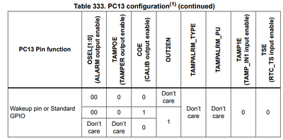

To enable the calibration output (" (1Hz) on pin PC13"), the RTC_CR_COE bit need to be enable.
In order to use the PC13 pin as standard GPIO you need to respect the condition given by the table 333. inside RM0440:
Maybe one of this condition is not ok.

Mongolov saw '(1Hz) on pin PC13. So, I guess that is the RTC calibration output is enabled on RTC Output 1.
And to use the PC13 as the standard GPIO Pin (GPIO_INPUT) he need to follow condition given by the table 333.
