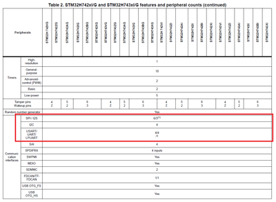

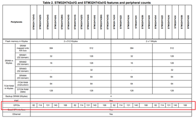

Anyway, you can refer to the datasheet. For example in case of STM32H742xI/G /STM32H743x / STM32H753 Table 2: it shows all the instances available on the MCU.
For example for the GPIOs number, it depends on the package:
SPI/I2C/USART instances:
But becarefull, you need to check if all these instances could be used in parallel.

When you say STM32H, it could be STM32H5 or STM32H7.
