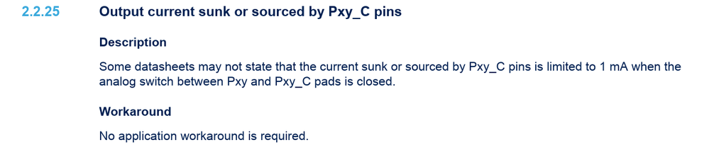

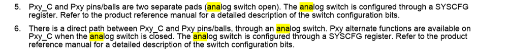

You mean this :
AND then from chip errata :
So you can use them, as you like , just be aware : these pins are connected by a small analog switch and will not survive > 1 mA in or out current. (And i know...i tested it and can confirm: then pin function is gone...)
