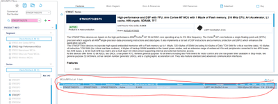

if you click pinout in Cube , then can select : list pin compatible... try:

Dear AScha,
In my case it only gives me one processor. Many thanks for your reply though.
