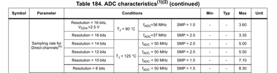

ie H743 has 3 ADCs, each can :
maybe possible: use all 3 ADCs in interleaved mode, so possible 21 Msps at 10 bit .
