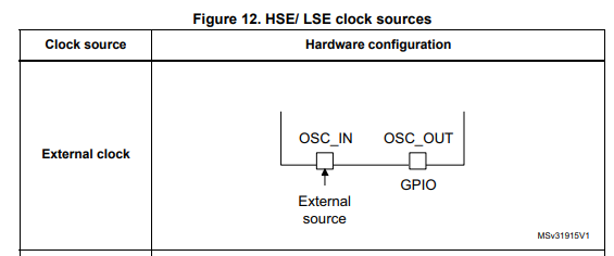

In the documentation for the STM32F030R8T6 chip, specifically the "RM0360 Reference Manual", there’s a diagram showing how to connect an external crystal oscillator ("Figure 12. HSE/LSE clock sources"). In this diagram, the crystal is connected directly to the OSC_IN and OSC_OUT pins, with no series resistor on the OSC_OUT line to limit the drive level.

@mega3psp wrote:In the documentation for the STM32F030R8T6 chip, specifically the "RM0360 Reference Manual", there’s a diagram showing how to connect an external crystal oscillator ("Figure 12. HSE/LSE clock sources"). In this diagram, the crystal is connected directly to the OSC_IN and OSC_OUT pins,?
No - in the case of an external oscillator (ie, an external clock), it is connected to OSC_IN only - the OSC_OUT pin is free for use as GPIO:

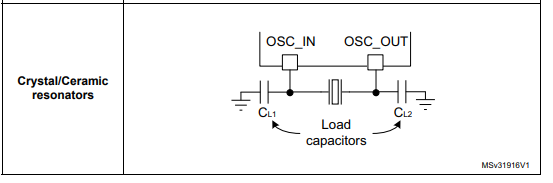

Both pins are only used in the case of an external crystal:

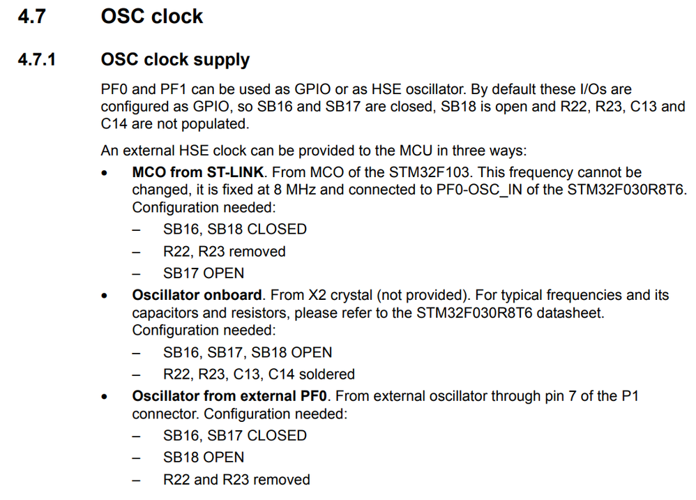

@mega3psp wrote:on the STM32F030 DISCOVERY board, ... I added the crystal I wanted to use
Did you also remove SB16 et al - to disconnect the drive from the ST-Link?
2025-03-28 1:41 AM
The issue was indeed caused by the SB18 solder bridge being in place. After I removed it, everything started working as expected. That is, OSC_IN is the input and OSC_OUT is the output. So, to limit the drive level, the R22 resistor on the STM32F030 DISCOVERY board should be used.
