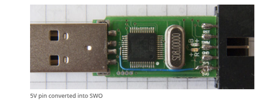

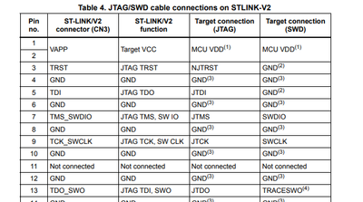

>Didn't know the STLINK V2 does SWO
see manual:
on cheap V2 "clones" you have to solder it yourself, to get swv :
