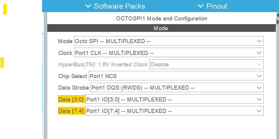

Here are the configurations for both OSPI1 and OSPI2 in STM32CubeIDE:
  • OSPI1 Configuration:

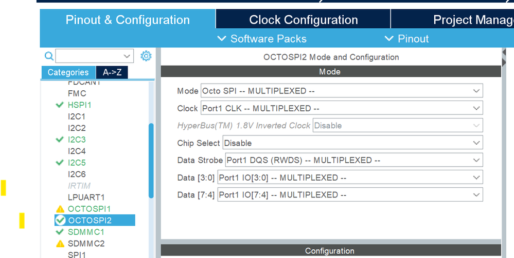

  • OSPI2 Configuration:

However, when attempting to access the flash memory with OSPI2, we are unable to perform these operations.
->The Chip select pin is not configured for the OCTOSPI2 in OSPI2 configuration.

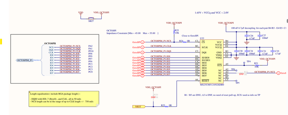

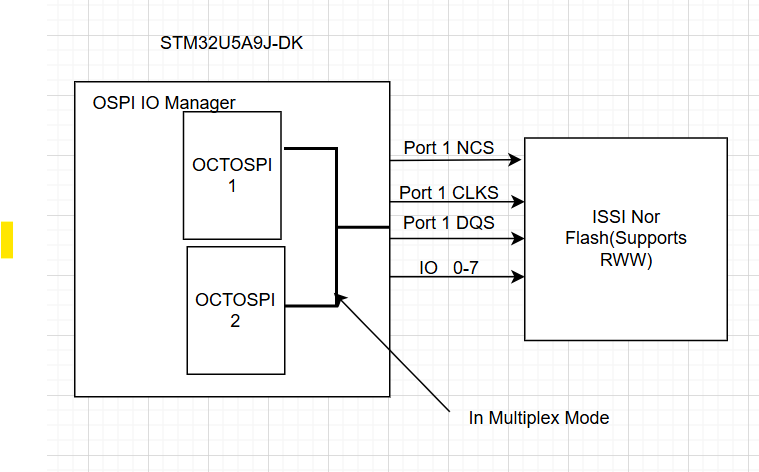

As mentioned, we understand that RWW needs to be supported by the Octal SPI NOR flash memory, which is true in our case. We are using ISSI Octal Flash Memory that supports RWW. We have connected the ISSI flash memory in place of the Macronix flash on the STM32U5A9J-DK as shown in the attached image.

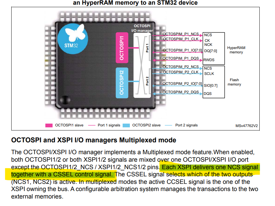

Referring to the AN5050 (page 25):
  • The xSPI IO Manager delivers one NCS signal along with a CSSEL control signal.
  • It also allows selecting the same NCS for both XSPI_1 and XSPI_2 using the configuration.
