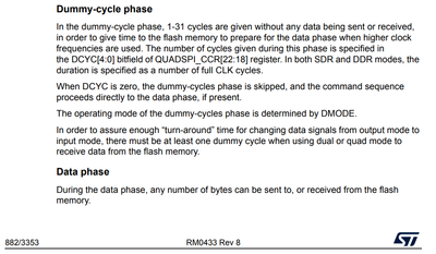

I want to understand the correct way to read this instruction UNIQUE ID (4Bh). To get this value, the datasheet says after the INSTRUCTION (4Bh) I need to add 4 bytes of DUMMY clock (32 clocks). After this, I will able to receive the 64 bits from the UNIQUE ID.

- I put the max dummy cycles allowed (31). Check it on the HAL lib and reference manual.

Well, your second try was correct. In the dummy-cycle phase, the microcontroller can allocate a maximum 31 cycles, however the memory needs 32 cycles to process the read ID.
Here is another option you can consider.
s_Command.DummyCycles = 31; //31 bits of dummy cycles
s_Command.NbData = 8+1; // 8 bytes of data + 1byte as dummy
