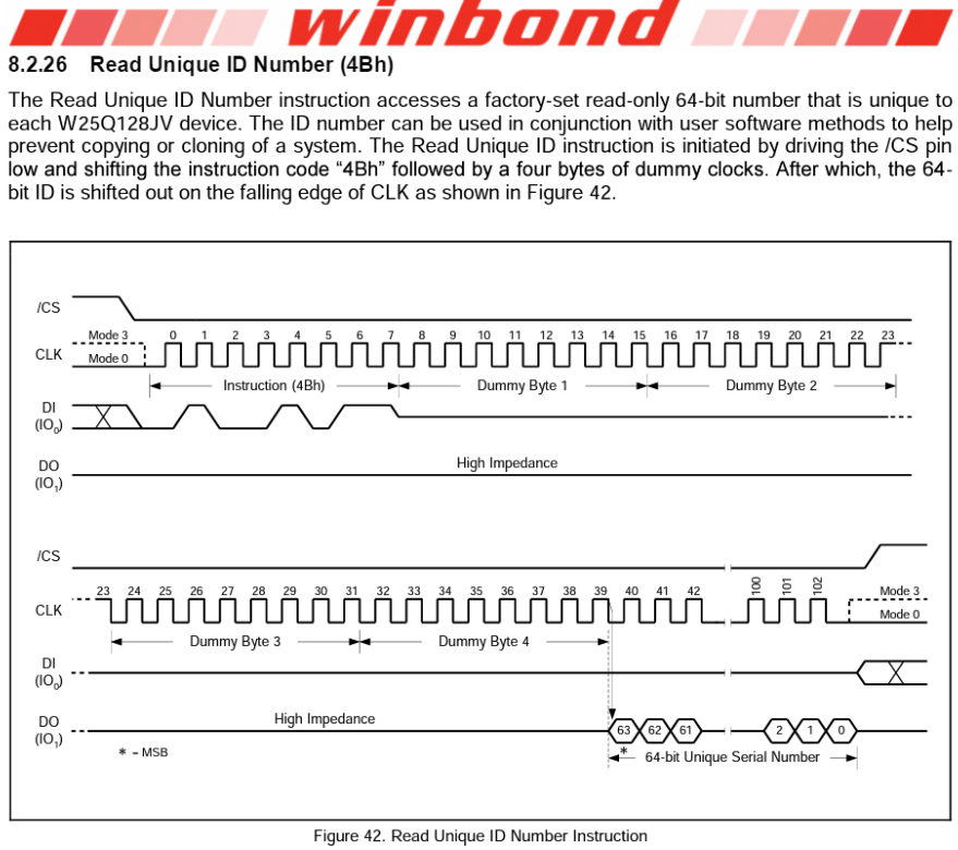

I want to understand the correct way to read this instruction UNIQUE ID (4Bh). To get this value, the datasheet says after the INSTRUCTION (4Bh) I need to add 4 bytes of DUMMY clock (32 clocks). After this, I will able to receive the 64 bits from the UNIQUE ID.

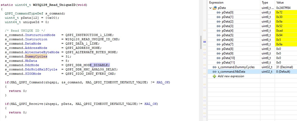

1) My first try was using the code below, but I always get corrupt data.
- I put the max dummy cycles allowed (31). Check it on the HAL lib and reference manual.
- read 8 bytes (64 bits from the UNIQUE ID)

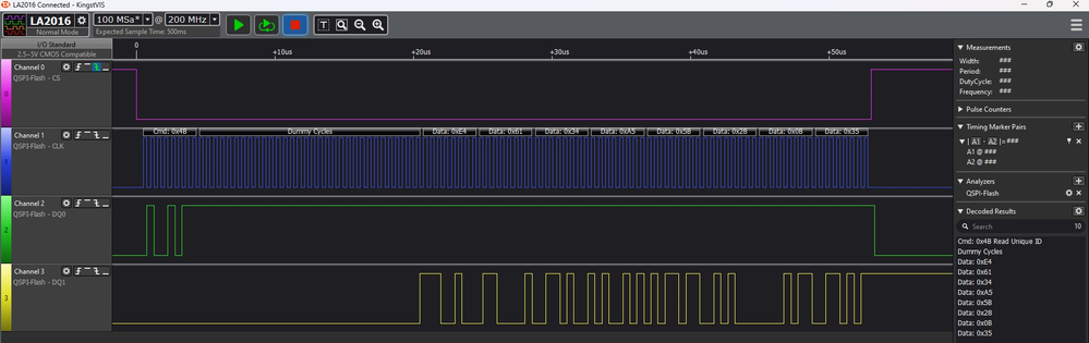

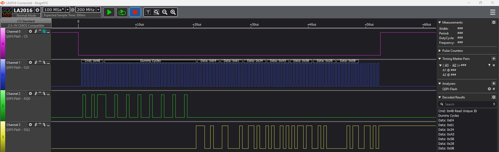

Looking the logic analyzer, I figure out the data is shifted to left. The last byte was not readed.

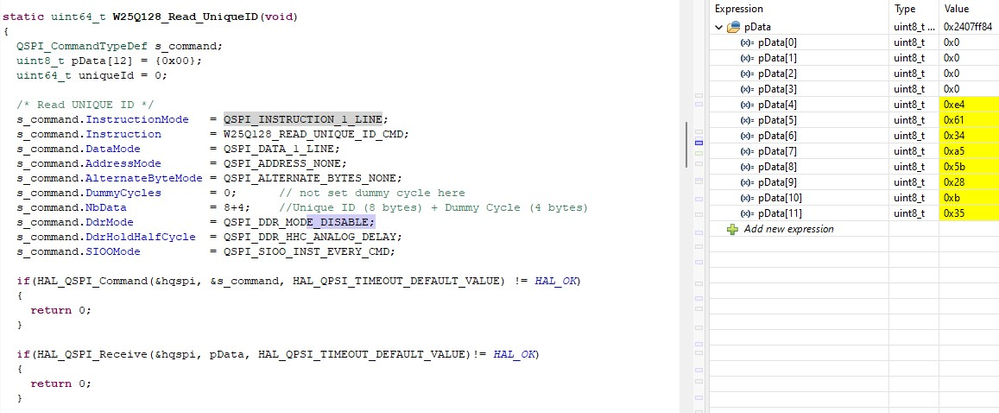

2) The second try was the code bellow:
- I sum the 8 bytes from UNIQUE ID with the Dummy bytes.
- the first 4 bytes are zero and the UNIQUE ID start at index 4 in pData array.
Looking the logic analyzer, the data is fine.

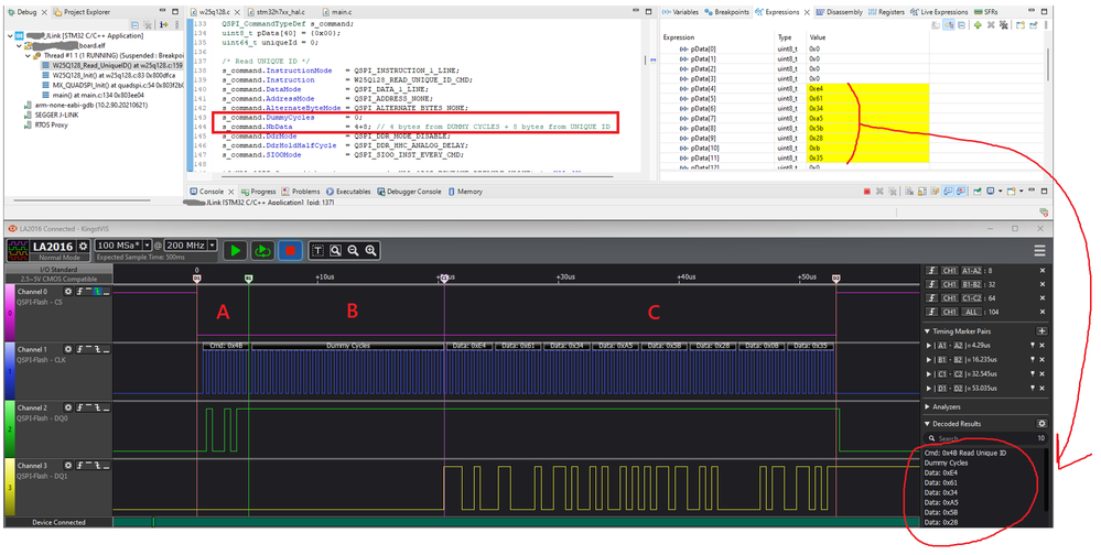

2023-07-05 9:04 AM
We did tests in 3 different boads. All custom boards has this memory (W25Q128xx).
The difference between this board is the MCU: STM32H753BI, 753II and 753ZI.

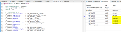

The following image show the code to read this UNIQUE ID and bellow the logic analyzer.
You can see the debug mode, the array pData match with the logic analyzer.

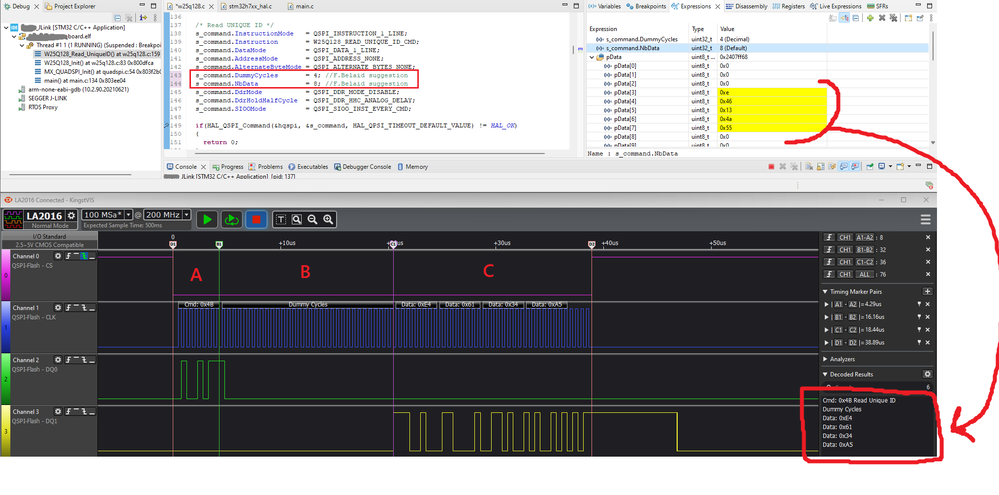

We setup the logic analyzer adding time markers and a counter in CLOCK line of the QSPI.
According the datasheet, we need in total 104 clocks, splitted in:
- A marker, 8 clocks: instruction (4Bh)
- B marker, 32 clocks: dummy cycles
- C marker, 64 clocks: 64-bits UNIQUE ID
- D marker, total of 104 clocks. This match with Figure 42 wave form in W25Q128 datasheet.
Whatever is the value for variable s_command.DummyCycles, I not able to see a different behaviour on my logic analyzer even in the oscilloscope...
We test it on 3 different custom boards, as I mentioned. The MSB byte 0xE4 always repeat. The rest of pData value is different. Putting the logic analyzer on it, the value matches with Data.
2023-07-05 9:09 AM
Hi @FBL , thanks for your reply!
We test according your suggestion, but not works. This is my output.
2023-07-06 6:53 AM

How's that going to work? It's frankly far easier to make the buffer bigger, keep the dummy cycles within bounds, and simply discard the leading slack bytes to extract the unique identifier.
