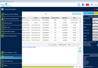

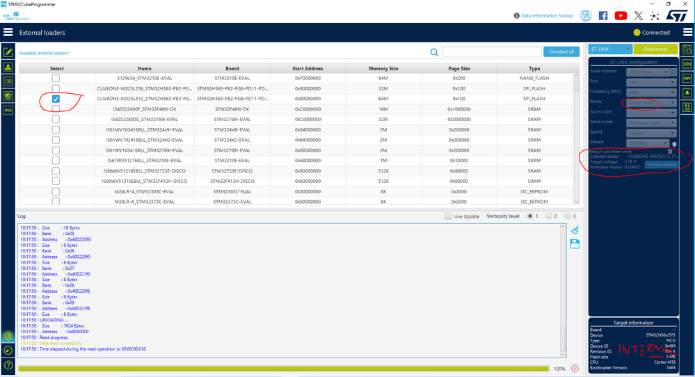

I have custom PCB based on STM32H563ZIT6 with external memory MX25L51245G(W25N01xx in schem.) and Riverdi display. I use ExternalLoader from https://github.com/cturvey/stm32extldr/tree/4dcb141b9cf6da2ee3fddf154d073bb6218a52e5/h5_mx25l51245g. Problem is that I cannot connect to the memory in CubeProgrammer. My aim is to completely program all code, images, texts and everything from TouchGFXDesigner I plan to use for pretty complex GUI so ex. mem. is necessary for me. I have attached my code and schematics to pcb.
But you set it in ...mem.loader ? ->
2025-09-11 1:19 AM
Yes, sure.
2025-09-11 1:36 AM
...and using/setting : software.reset + normal or hot plug... same ?
2025-09-11 1:40 AM
I tried, but no effect. It is probably some different problem.
2025-09-11 1:55 AM
As it's a custom board, it could be a hardware issue.
2025-09-11 2:28 AM
That is the reason I have attached schematics. So what problem might be there ?
