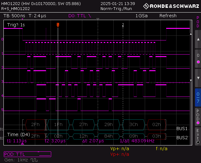

I am debugging with my Scope, I have a digital Probe on all 6 lines (CSn, Clock and DIO0-3) and I can see the communication.
First issue:
I am sending the command "0x05 - read mode register". I can see the outgoing communication on the scope, I can see the incoming communication on the scope. I can see on the scope that the RAM is sending a response - with the default Mode Register Value. But the Variable I am reading ins, is not updated with that value.

I see literally in the scope 2 Bytes: 0x05 (=read Mode register command) and the response 0x40 - which is the default value of the chip according to its datasheet. But the buf variable, as well as the SRAM_modereg variable, where it is copied to remain 0.

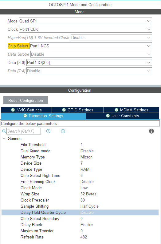

My OSPI Config is like in the screenshot below:
I already went through the AN5050 and tried to configure the Peripheral according to table 8. This is where the refresh rate comes from - even if I have no idea, if that applies to my chip or not. I guess not ..
if "DQS" is "Delay Hold Quater Cycle", then it's disabled.

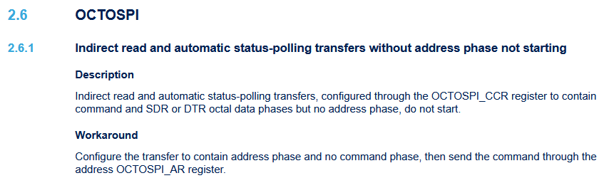

The errata describes the issue "the other way round":
it says it would not start, when NO adress phase is configured. I have the issue it will not start, when an address phase is configured, I can only start with NO adress phase ...

I tested only with address = 0 ... But as soon as I entered an address >113, the Peripheral did not start. As I am writing 16 byte (for testing) my "effective max. address was 112.
I tried to set the the address in the command struct to 0 first and set the Address-Register manually,
hOSPI->Instance->AR = addr;
after calling HAL_OSPI_Command(hSramOSPI, &cmd, HAL_OSPI_TIMEOUT_DEFAULT_VALUE);
but that made no difference.
I first though the addresses had to be 4-byte aligned, because I was testing with address 0 and address 259, but that was not the case. If I replaced 259 by e.g. 35 it still worked.
I tried to __REV(the_address) but that did not work either, and it does not reflect the datasheet. A visual comparison of the bus in the scope also confirms, that the address must not be __REV() ..ed. They come out "un__REV()ed" MSB first, as required by the chip.
This "address barier" existed in SingleSPI Mode as well as in QuadSPI Mode.
This 128 Byte barrier somehow seemed to have to do with the device size in the OCTOSPI_DCR1 Register. There are 5 bits to encode the device size. My initial config was "7", but this was wrong. The SRAM has 256kByte, so I wrote 7 for (7+1) for kByte, but you have to enter the size in Bytes instead, so the right value would be 17:
2^(17 + 1) = 262.144 Bytes - at least I thought.
If I did so, the Peripheral was not started again when I tried to write to / write from the last 16 bytes of the chip. The "17+1" comes from the Manual, that writes the value for "Devicesize" should be set in a way that "2 ^[DEVSIZE + 1]" equals the number of bytes in the device.
This might be eventually a bit misleading. For my device the value needs to be 18, 2^18 = 262.144 Bytes, because I have a 256k SRAM.
With the correct settings (Device-Size = 18), I can now read and write from the first Byte of the SRAM to the last Byte of the SRAM and get the results I expected.
I see an issue in the HAL Driver. It simply does not start the peripheral, when an address > the allowed device size is requested in the command struct. IMHO it should come back with an HAL_ERROR immediately, instead it does nothing until the timeout is over. Which leads you to debug the hardware instead of looking for the error in a wrong configuration.
