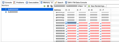

@TDK wrote:How about in non-memory mapped mode? Does the Memory Map view also return 0x9999 everywhere in this region?
By "Memory Map view", do you mean in STM32CubeProgrammer? This reads the values as expected (see attached screenshot) - apologies if I've misunderstood.
2025-01-02 9:24 AM
Aha sorry, I think you probably meant the Memory tab in the STM32CubeIDE - yes, this also returns 0x9999 (screenshot attached)

Yes, this is how you look inside the memory when "Memory Mapping" is enabled.
If you don't map this will Hard Fault
If the read command template you supply in mapped mode is wrong, you'll get confused junk from the memory, or static bytes if the command is wrong/ignored.
By template I mean the same Read Command that works in the direct mode, but now stuffed with an address supplies by the MCU bus on-the-fly.
You can't use both modes concurrently, you can't send commands in memory mapped mode, you need to HAL_QSPI_Abort() to exit, and use HAL_QSPI_Command(), HAL_QSPI_Receive(), etc otherwise those commands will fail with a busy error.
