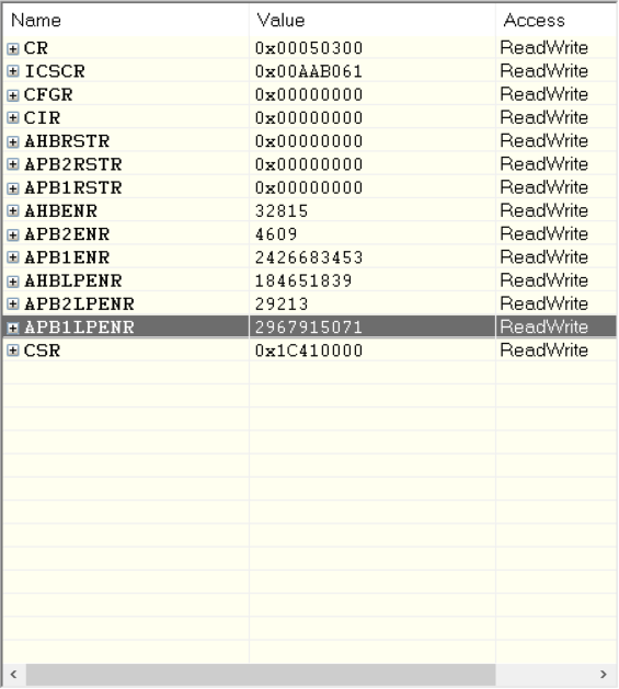

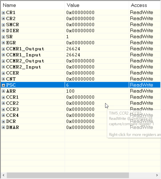

2020-12-16 10:55 PM
this my register ..
Yu can tell me the values of f clock and if
Frequency_pwm = ClockFreq / ((PSC + 1) * (ARR + 1)) = 2.85 KHz ?
Thanks
2020-12-17 11:30 AM
RCC_CFGR.SW=0 which means you are running from MSI, RCC_ICSCR.MSIRANGE = 0b101 i.e. MSI runs around 2.097MHz. There's no APB prescaler in RCC_CFGR i.e. APB thus TIM clock is 2.097MHz. TIM is set to period 2097000/(6+1)/(100+1)=2.966kHz. TIM configuration is not finished, it's not running, nor is any channel enabled in CCER, nor is any CCRx set to other than 0, so I don't know what would an output look like exactly.
Note, that MSI is an RC oscillator, i.e. it has some error, see datasheet.
