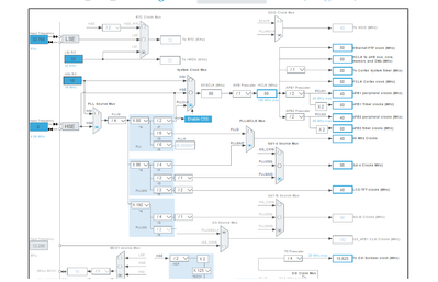

Here are our system clock settings (we heard they are important for the interrupts to work properly so we only changed as little as possible):

Here is a picture of our clock setup graph:
