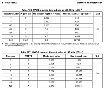

The datasheet shows calculations for min/max timeouts under various conditions.
Note that there's a typo here at least. The Prescaler "46" should be "64".
> LSI clock is 24KHz as I not enable the /128 Prescaler before IWDG.
Note that LSI is 32 kHz, not 24 kHz.

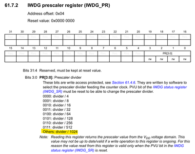

Reference manual suggests the prescaler can be 1024. I'd trust the RM over the DS.

@TDK wrote:The datasheet shows calculations for min/max timeouts under various conditions.
==> Ok so I have the same value than the datasheet so my IWDG should be well configured. That solve problem 2.
==> Yes sorry 32KHz.
==> This is the prescaler of IWDG that can go up to 1024, the one for WWDG is maximum to 128 (but we can try to reduce PCLK1 but it is not what I want).

Here the example code as use as reference and that clairly said that it set iwdg counting for 762ms :
Maybe the value was updated but not the comment. Classic :)
2024-07-19 9:04 AM
Generally, when a new chip series comes out (e.g. the U5), the examples, documentation and code quality lag behind a bit. Likely that's what is happening here.
Agreed, seems like the comment is just wrong. Probably if you dig into similar examples on other chips you would find one of them where the math in the comment is correct and it just wasn't updated for this example.
